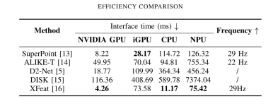

Feature Netzwerke Benchmark (Quelle: Why Not Replace? Sustaining Long-Term Visual Localization via Handcrafted-Learned Feature Collaboration on CPU)
